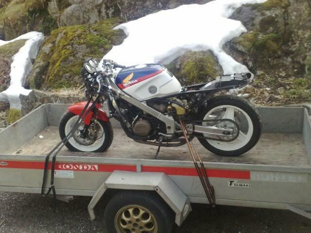

So here is my humble offering as a start point.
I've lived here in Norway a couple of years now and have a couple of mates who ride, 1 english 1 australian.
but i met this norwegian and got talking about racing and he told me he'd recently bought an '86 VFR 750 (?) which he intended to race (??).
i dont want to get into why buy a 86 vfr for racing, this is about the hows of the project not the why's, i dont get it myself.
so, as i am wont, i found myself offering to help. wtf, why not i thought.
so he'd bought a RC30 bodywork kit and cbr900 wheels, and i said id help out and kinda took over and basically did it myself.
also i should add, for reasons best known to himself he wanted to keep all the lights available so should he want he can take it on the road.
it's all good, who else here has made a quick release back brake indicator assembly??
starting point..

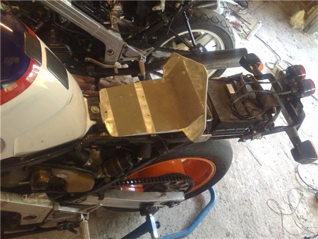

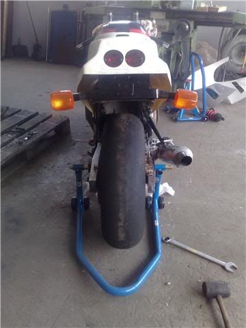

fabricated seat and q-release back brake indicator assembly. cbr wheel had all spacers so plug and play.
from the back

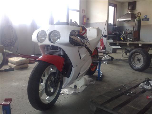

front end with street fairing, note re-routed oil coiler

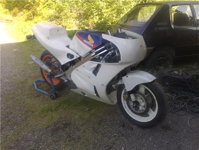

finshed job
i have more pics if anyone is interested.
difficulties: none really beyond the tedium that is bodywork.
we put some heavy duty clutch springs in too, did the brakes, and fitted an ohlins shock.
all in all a good experience, would of been cheaper for him to just buy a 94 blade from britian and bring it to norway, not riding on the road no import duty would be necessary. but hay its his life and his money...

hmmm...that oil cooler...
in the pic its balanced there, but thats where he wants it. i advised against putting it so far forward for 2 reasons:
1 its right in the line of fire, and 2 its right over his front brakes.
i think the thing needs to be buried as far as sufficient air flow allows.
my opinion fell on deaf ears so i silently withdrew from that area of the project.
i'll help anyone with any project because i love it...no problem...but i wont do anything i think is dangerous or incorrect.
i even tried the peer pressure approach, as in, if he dumped a load of oil on the race line and has race day closed down, there would be several racers baying for his blood, which may be all over the track if oil gets all over the brakes, which it would in that position.

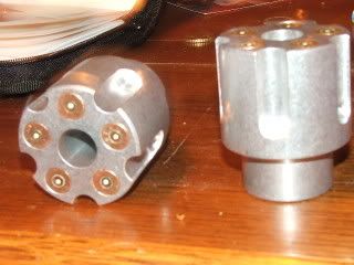

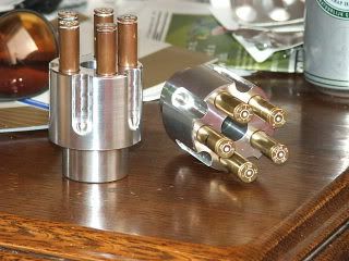

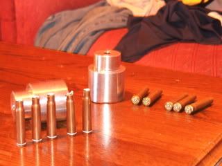

schiezer from a few years back...

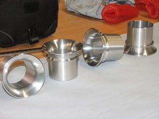

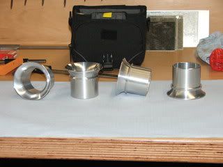

velocity stacks for a drag hyabusa turbo...

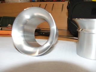

phil

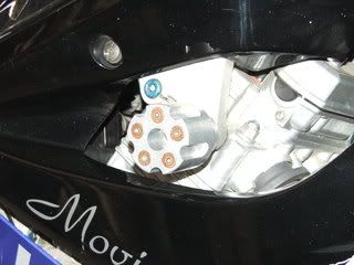

Can you see where it's hidden?
phil
Re: PROJECTS.
Post by phil »
on the end of the sub-frame.
cooler than penguin piss that!!
burning your leg to a cinder on them pipes would be a small sacrifice for such a thing of beauty.

Oh I almost forgot......... phil the bellmouths look nice, but they work much better with a full radius on the end that goes round back on themselves, those 'cut' the air where the radius finishes...............apparently :lol: An Aprilia RS250 a friend bought had hand grips like those 6 shooters, I assume he got them off one of the 'bros'................ :D
If Jesus had ridden, he would have rode a two stroke
phil
Re: PROJECTS.
Post by phil »
TwoStroke Institute wrote:....but they work much better with a full radius on the end that goes round back on themselves, those 'cut' the air where the radius finishes........

i had to remachine those. i made them to the exact specifications but the lad came back to me.
he wasn't happy with the rad on the end. i could see it immediatly, the venturi effect i believe. (erm...immediatly after he said it! ;))
i didn't mind they are the only things i can remember charging someone for, normally stuff i make is for mate's so i never charge 'em.
but you dont get full marks for observation because they were 5mm too long also! :lol:

what bike is that ? I recognise a Ducati somewhere, but it's wild !
Yeah, We are owed a story on that one.
Would you believe it is a multistrada?
User avatar
jihem
Posts: 258
Joined: Wed May 21, 2008 7:26 pm
Re: PROJECTS.
Post by jihem »
...in a previous life :)
